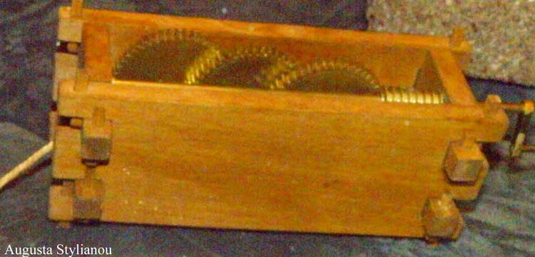

Полиспасты
Greece, Ancient Greek Technology
Baroulkos or Varoulkos, Heron of Alexandria. Photo : Augusta Stylianou Artist The Baroulkos is a weight-lifter in which a succession of gears makes it possible to lift large weights with small effort by turning a crank. From "Ancient Greek Technology" exhibition at the Evagoras & Kathleen Lanitis Centre in Carob Mill Limassol Replicas and Reconstruction by Prof . Kostas Kotsanas and his students Ancient Greek Technology Ancient Greek Inventions Ancient Greece Medieval Greece / Byzantine Empire Modern Greece Science, Technology , Medicine , Warfare , Biographies , Life , Cities/Places/Maps , Arts , Literature , Philosophy ,Olympics, Mythology , History , Images Science, Technology, Arts , Warfare , Literature, BiographiesIcons, History Cities, Islands, Regions, Fauna/Flora ,Biographies , History , WarfareScience/Technology, Literature, Music , Arts , Film/Actors , Sport , Fashion Cyprus - World Greek-Library - Scientific Library Contact - Statistics // www.mlahanas.de
